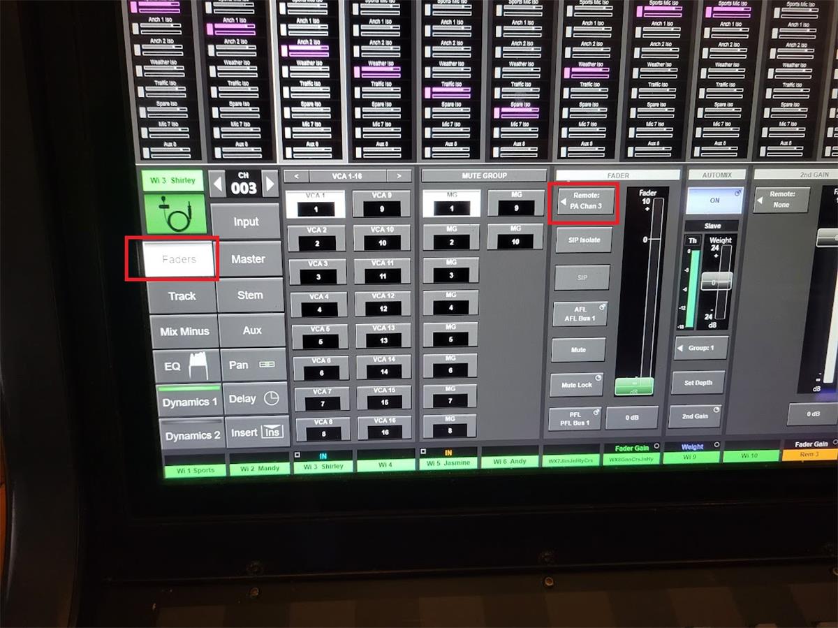

    Found the solution.
    This is a 2 part process on the SSL Audio Board.
    IN SSL:
    1. Assign PA Channel to SSL Path
      MENU --> SETUP --> OPTIONS-->  PA
    2. Enable Remote Control of Individual Fader in Fader Detail View
