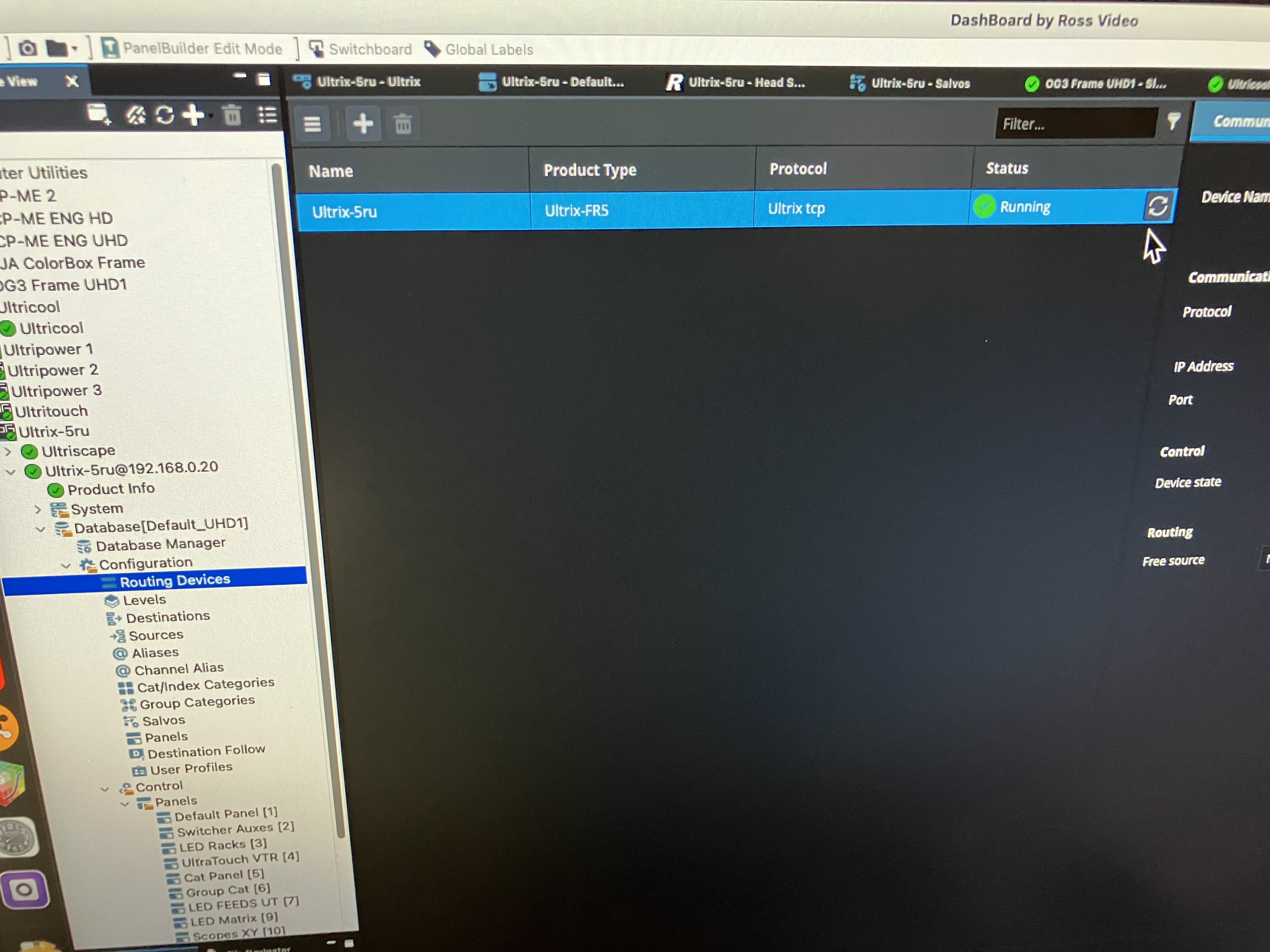

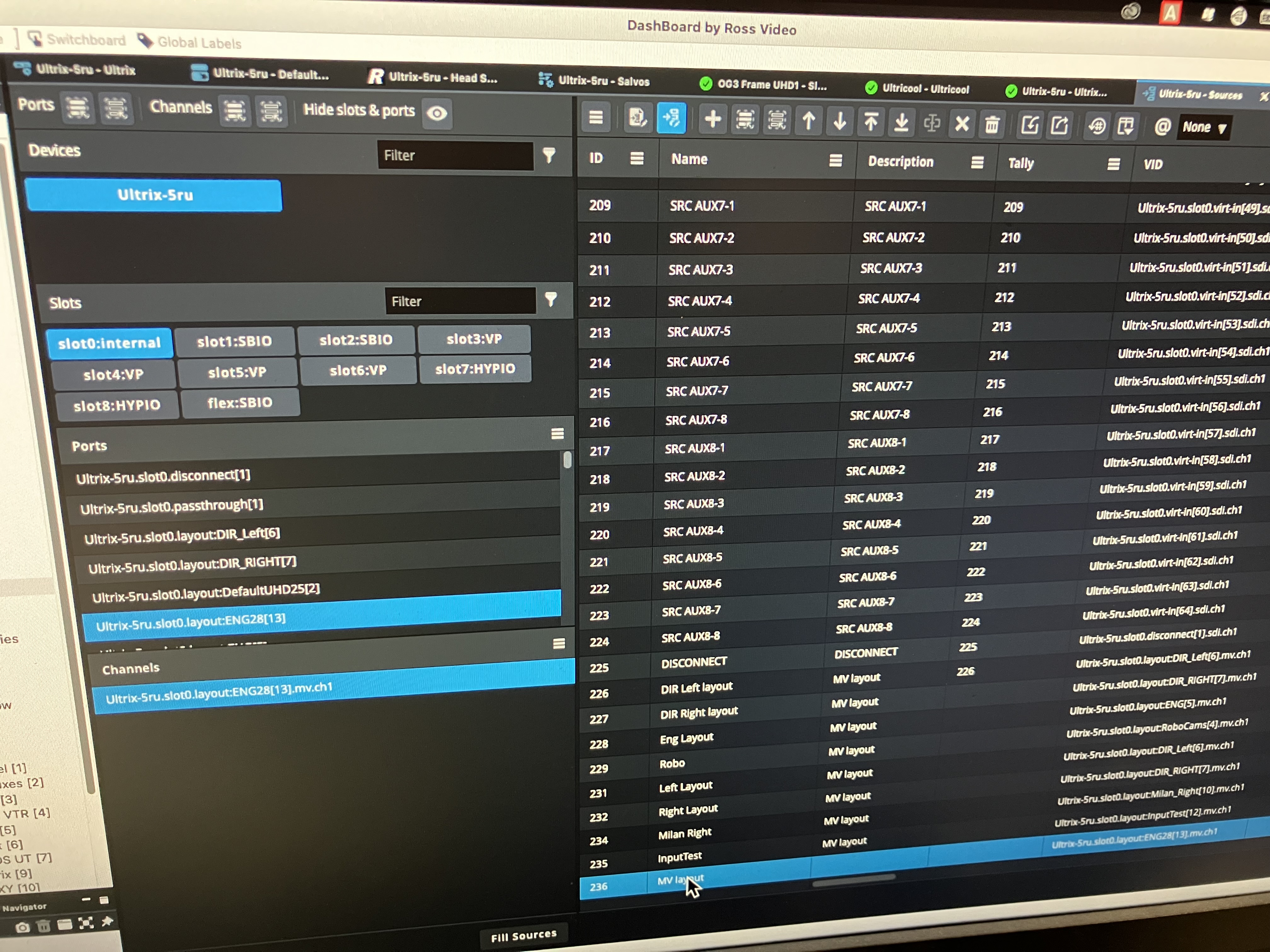

    I'm trying to add this same setup to my Ultrix running 6.7.1. It is missing a lot of recent ultriscape layouts. I don't see anywhere to refresh the IO like I remember in older versions. Do you have any suggestions on how to bring recent layouts into the source list?
    Brent T
    Director of Broadcasting
    Crossings Community Church
  • 5.  RE: Ultriscape - Head Selection Layout Recall with Salvo?
    Posted 04-10-2026 15:23
    After I create the layout I have to go to this page and refresh the devices.  Then the new layouts will appear in the internal source list of database.

    We had to type the old ones in that did not show up in the drop down after the Ultrix update.  Guessing it's a bug.
