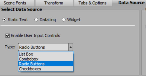

I needed confirmation that this method of live updating using data from dropdown lists wouldn't work.
It's a shame, because it would be an extremely efficient solution in the scenarios I envisioned.
If you had a moment to watch my demo video, you might agree.
I'll probably have to choose the datalinq server method of updating data in an Excel spreadsheet. I wanted to avoid this to stay solely within the Xpression app interface and save time, which is already scarce in certain situations.

Hey Tom,
I can't watch the video right now as I'm traveling with poor data but I understand what you mean. The input controls are not designed to be used while the scene is online.
You can used widget drop-down list like this.
https://www.rossvideo.com/resources/ross-university/using-the-xpression-clock-and-timers-widget/
Or you can use external data such as dashboard.
If you change the data in the template data entry in the sequence and take the item again it will force an update but it won't animate.
The normal workflow method is to duplicate the item in the seqence list and then have transiton or transition logic of some kind.

Thank you, but I don't quite understand what widget you're referring to.
I don't think this solution will suit my needs.
Am I to understand that dropdown lists cannot be used in live data updates?
