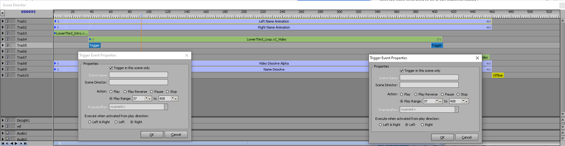

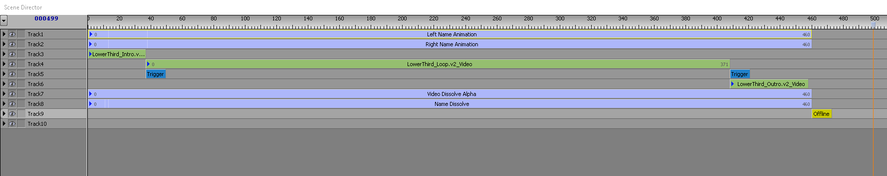

    2. In the scene director below, I broke up the animation for a lower third into intro, loop and outro.For some reason, only the intro plays out and then when it gets to the loop it is just static. Any thoughts on why this is happening?
    3. I added a trigger so that it will continue to play the loop in the middle but it sort of blows past it. What is the best way to play out the intro, then loop until i am done to animate out the outro?

    As a workaround you can trigger other scene the loop the video.
    Create a new scene just with the VIDEO LOOP.
    On main scene use just the INTRO and OUTRO VIDEO on timeline, use a PAUSE or LOOP for timeline and place a trigger to start the video loop scene.
    Place 3 quad for each video (INTRO, LOOP, OUTRO) and make them visible or play with the opacity to see them only to a specific moment (hide the loop quad before outro).

      2. Make intro animation scene director and then make an loop animation director which should also include your out animation. You also need an out scene director but this will only contain a script.
      Place trigger on end of intro to trigger loop/out anim.
      Have a text object that can be either 0/1 .
      On the loop animation where you want the loop or out to happen place a script.
      The script will be as follows.
      Dim textObj As xpTextObject
      Dim curVal As String
      Dim sd As xpSceneDirector
      scene.GetObjectByName("OutCheck", textObj)
      curVal = textObj.Text
      scene.GetSceneDirectorByName("Loop", sd)
      If curVal = "0" Then
            sd.Position = 0
      engine.DebugMessage("loop", 0)
      Else
          ' (Do nothing)
      End If
      You'll need a script on the out that sets the text to 0 and a text onOnline that sets it to 1, let me know if you need those as well.
